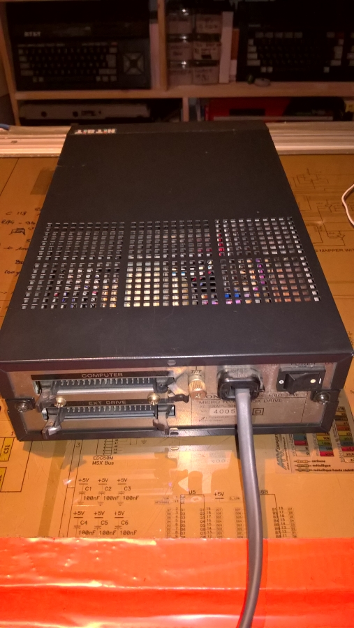

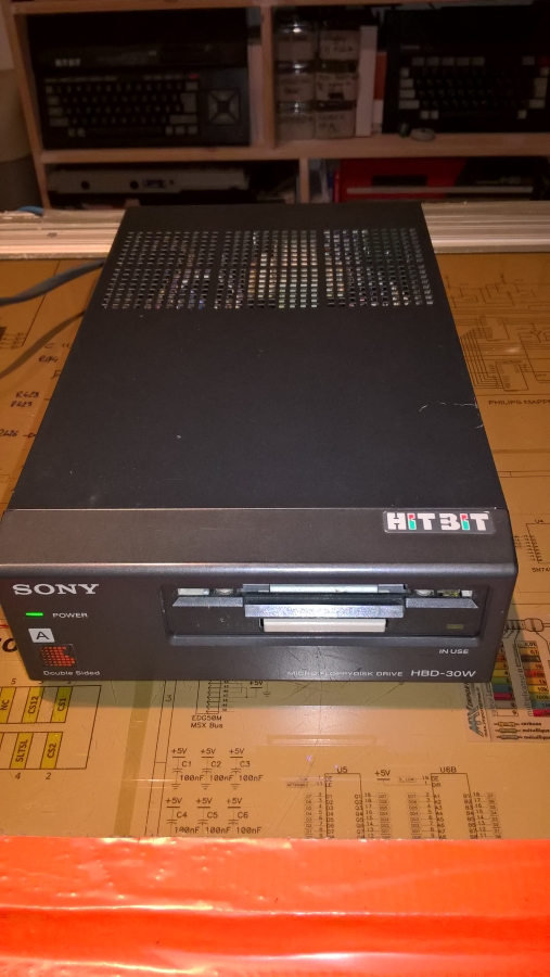

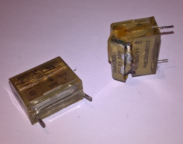

VOICI UN PETIT POST CONCERNANT LE SAUVETAGE D'UN SONY HBD-30W FLOPPY DISK DRIVE
PROBLEME SUR 2 CONDO "MIKA"
:gre :gre :gre
ET MODIF NAPPE A L'ENVERS COMME LES DRIVE DE THOMSON...
:fou :fou :fou
MODIF DU DRIVE EN GOTEK :top :top
ET VOILA REPARTI POUR 30ANS....
