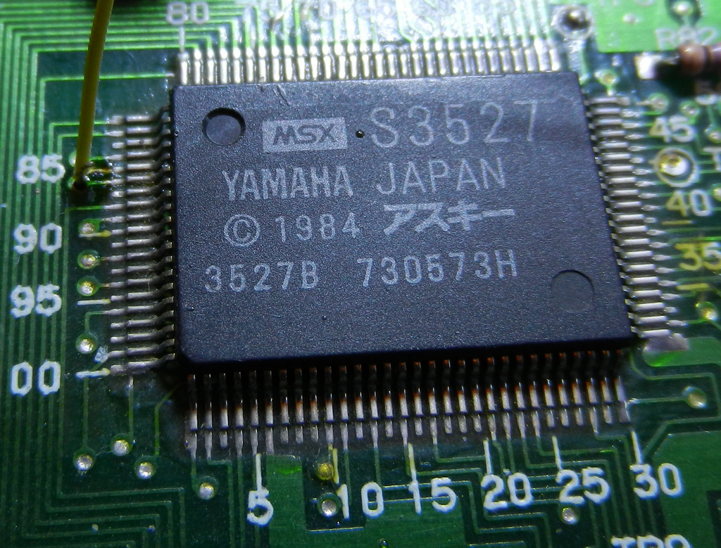

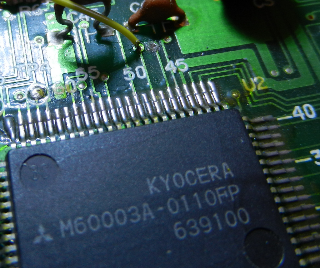

Le 06/10/2016 à 16h03
i insert the 2 x eprom in a 8245
jp1 is closed , jp2 is open
see the pictures for zooming pin /CS12 and SLT3/30
/CS12 Pin 86 os S3527
/SLT3/30 Pin 48 of Gate array
A14 on pin 4 Z80
power on -> blue screen -> Basic 3.0 -> is ok
the set rom is for an AZERTY Keyboard
