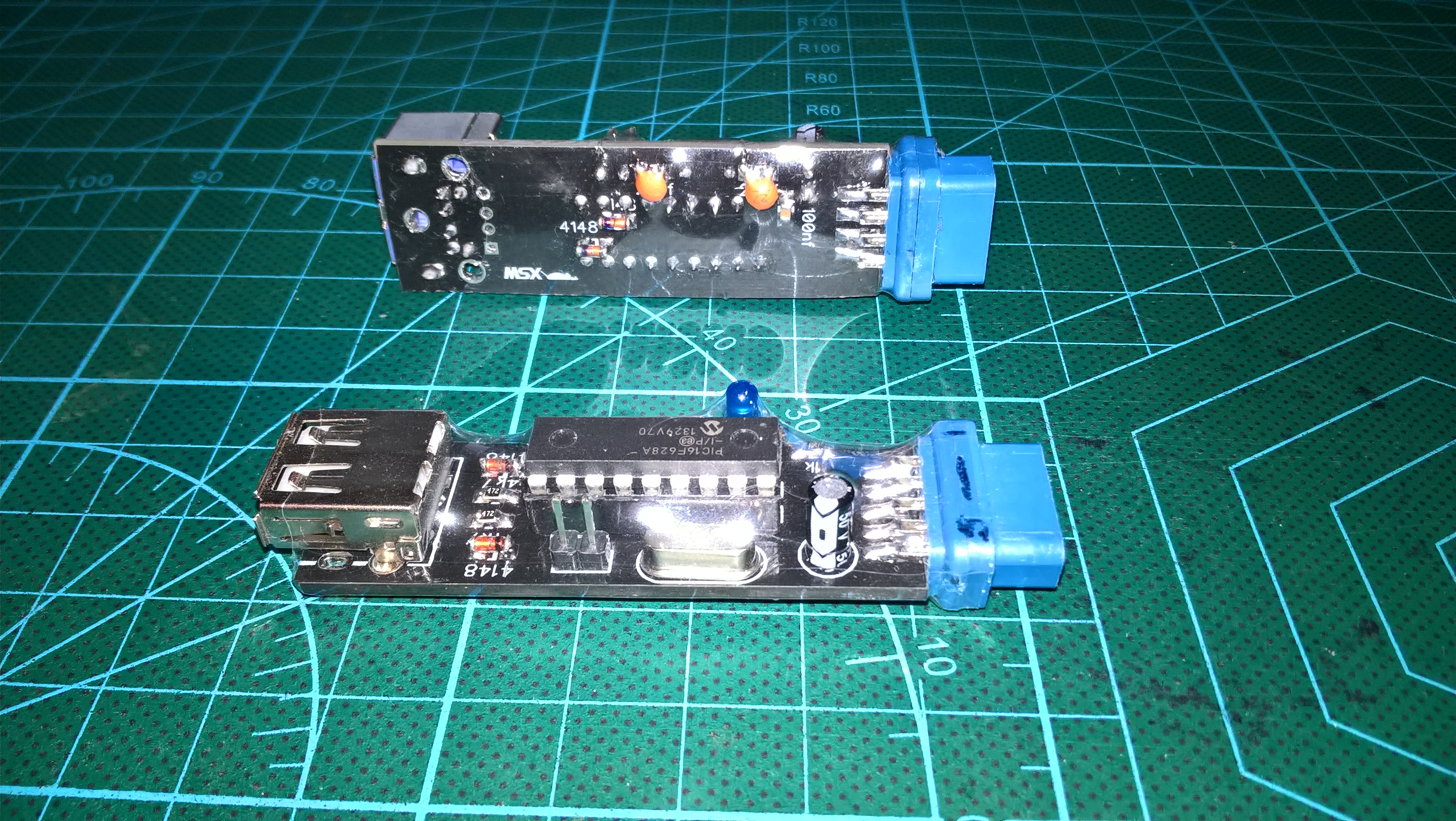

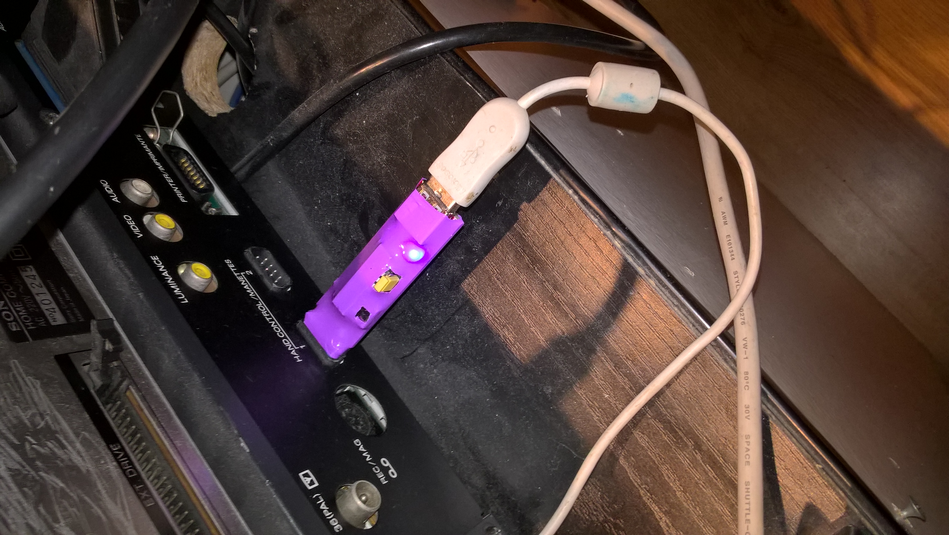

non le port joystick !!
j'ai ca si ca t'interesse !!
wp_20190522_18_32_37_pro_59ba1
wp_20190522_18_30_50_pro
wp_20190608_08_07_55_pro
wp_20190608_08_06_59_pro
