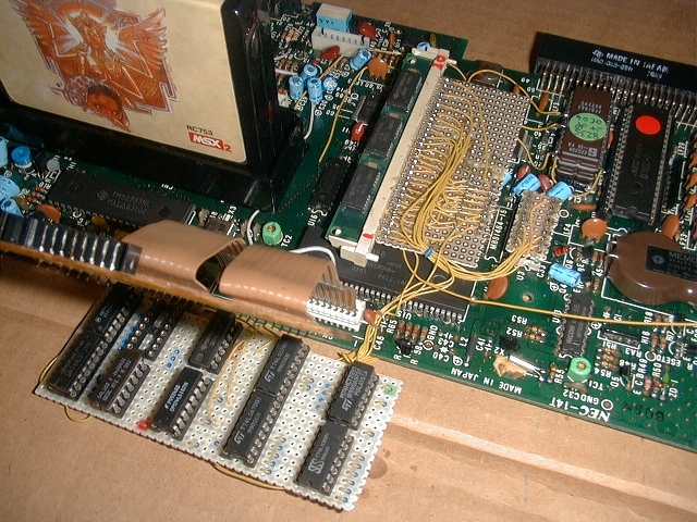

Messages: 10902
Le 03/10/2016 à 12h25
Make a 64k 27C512 eprom with the 64K files and plug on 8235/8245
Make a 32k 27C256 eprom with the 32k file
8235-8245-2P.rar
on the 27C56 lift the pins 1 , 20 , 22 , 27 and solder upper the 64k
make a wire pin 1 Eprom to 28 pin Eprom 27C256
make a wire A14 pin 4 Z80 to pin 27 Eprom 27C256
make a wire /CS12 pin 3 of Slot to pin 20 Eprom 27C256
make a wire /SLT3/30 pin 48 M60003A to pin 22 Eprom 27C256
after you have :
32k Bios at 0000H in Slot 0 ( in the 27C512)
16 K Subrom at 0000H in slot 3.0 ( in the 27C512 )
16 K Disk at 4000H in slot 3.3 (in the 27C512 )
16 K Subrom at 4000H in slot 3.0 (in the 27C256 )
16 K Kanji rom at 8000H in slot 3.0 (in the 27C256 )
good luck

Messages: 10902
Le 04/10/2016 à 11h08
the 27C512 is just inserted in socket
i sink you have QWERTY keyboard : verify if pin 22 of 27C512 ( A16 ) is on ground else invert JP1 JP2
just the pin 1 of 27C256 ( VPP )is putting to the pin 28
the final version have 2 eproms
